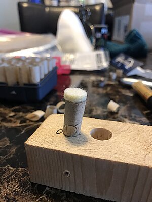

    So I was curious to see why no one ever uses blank pistol cartridges in re-enacting? Doing some research into pistol ammunition it’s become painfully clear that they were issued ammunition that was a paper or linen cartridge in an arsenal pack much like rifle ammunition in varying styles and fashions. But the only types of reloading I have ever seen in any frequency is either a cylinder swap or tearing open a paper cartridge much like a rifle and using the paper as wadding in an attempt prevent a chain fire and hold the powder in place. What say you all about what I have created? They are made with coffee filters for the paper that have been soaked in potassium nitrate and I glued wander wads to to top as a measure of safety to prevent chain fires.Click image for larger version

    Re: Pistol Cartridge Project
    'morning,
    Most event rules that I've seen prohibit the use of wads, as potential projectiles. But on a personal level, I'm curious to hear how well they work.
    I don't often carry a pistol (one event, where I do a civilian impression), and there I use a variant on the rifle type cartridge. But it's pre-packaged powder and filler in a cigarette rolling paper, all I do is tear the back open and ram the whole thing. Seal the chamber with lube.
    Best of luck in your project!
        Michael I plan on testing this weekend. I personally think that the myth around wander wads comes from years of re-enactors passing down old wives tales much like everyone elevating rifles at far distances and the fear of shooting a ramrod 300 yards so we just don’t do it. I will update once I have tested but I don’t see a felt wad gaining any sort of real velocity and if there is any real fear exercising good muzzle discipline is always a good practice when it comes to pistols.
