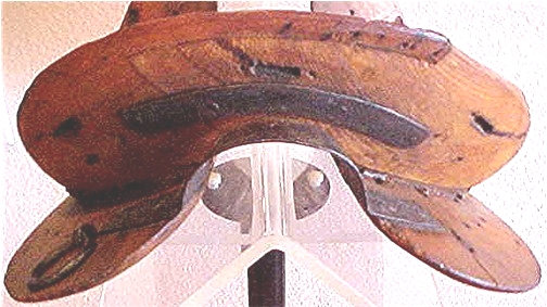

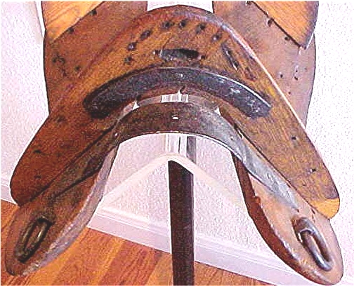

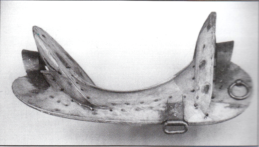

            I have a question to ask anyone who has ever seen an accurate Mcclellan tree without its rawhide. I am to get a Mac tree from Steele soon, and he has said that besides the finish work in sanding, I can forge my own irons for the pommel and cantle. I read on page 162 of Ken's book that both the federals and confederates used these irons to "be used in attatching the pommel and cantle to the bars". I have seen carrico's trees and they have tabs which appear to screw into the pommel and are attatched to the iron arch in front in three places- about ten oclock, twelve and two. Did the original macs have such tabs? I have canabalized an old mac I found in an old barn(1904 I think) and while it has both arches, they in no way support the pommel or cantle. They only add strength between the bars. Somebody please fill me in on this so I can begin making them. by the way, those on page 162 show no means of supporting the pommel/cantle either;federal or confederate.
            john tucker
            Greg Tucker
              Re: Steele and Miller Saddlery
              Hey John! I thank you for this post and for the private message. Please allow me to answer your similar questions here on this forum as a means to provide information to others that perhaps, have the same inquiries. I point out that there is a great disertation on the various models of the McClellan saddle tree in Dorsey and McPheeters book THE AMERICAN MILITARY SADDLE 1775-1945 that will give much more detailed information than I can provide here. I garnered alot of my information below from that great source.
              As you note, the Federal M1859 Mac had iron pommel and cantle arches that do not attach to the those appendages but do support them. Rather, as you describe, they attach to the bars of the Mac tree. Another seperate iron arch was countersunk into the pommel (and another in the cantle) as a means to support those portions of the tree. Later model Macs, the M1896 (and thus the M1904) I believe, had an improved version in which these metal archs in fact, do attach to both the pommel (or cantle) and bars at the same time.
              In answer to your more important inquirie as to what kind of arches or, as I note on page 162 "saddle irons" (CS Ordnance terminology) were employed by the Confederacy I suggest they were copies of that employed in the M1859 Federal Macs of the period albeit- often somewhat crude. The CS ord. officers were generally former U.S. Ord officers, familiar with the articles or at least had captured saddles in which to use as models so in short, they were familiar with them 1859 macs. However, while I have seen several references to these pieces in CS Ord Bur. correspondence and a couple of probable excavated pieces I can honestly say I have never tore down an original CS tree to learn its true employement. Though I never asked, the owners of the few surviving trees were probably not very favorably inclined to such an inquisition.
              More direct to your question as to "what to do" with your CS Mac I suggest you copy the M1859 Fed Mac as close as possible (which is what the CS Ord. Officers did) and not any "reenactor interpretations" regardless of their good faith efforts. How to do this? It would be best to get a copy of the chapter in the Dorsey/McPhetters book that talks about this. It containts numerous photos of all of the iron work and details sizes, rivets, rawhiding, etc. It is very detailed and enligtening. That is your best bet.
              Sorry I was not of better help.
              Ken R Knopp
                  John, the arches were most probably made of sheet metal stamped out and not forged.
